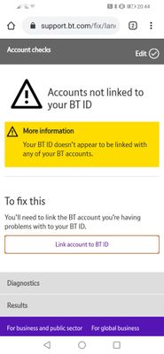

I have the previous version of the Smart Hub here that I was using with Plusnet until today. What do I need to type in the broadband username and password field if I want to try that hub instead?
Edit - I found the username. I can't connect with this hub either.
Edit 2 - I get this on the troubleshooting page. Clicking "link account to BT ID" doesn't do anything.

As a matter of interest, what speed are you supposed to be getting?
Did anything in the house switch on at about the time you lost the connection?
The account linkage may take 24-48 hours to update, as there may be open orders still.
I am wondering also, if there is still a pending activation which could take up to midnight, and you were on an old profile.
It could also be that there is a network fault, so it may be worth checking on the BT Status website.
https://my.bt.com/consumerFaultTracking/public/faults/tracking.do?pageId=31
