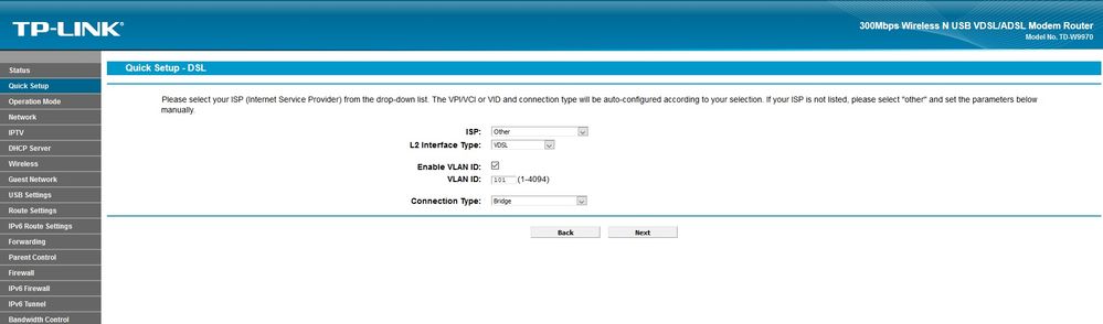

Have a look at this thread, it is for the 9980 but should be similar.
You need to configure the VLANid of 101 on the TP Link but not PPPoE.

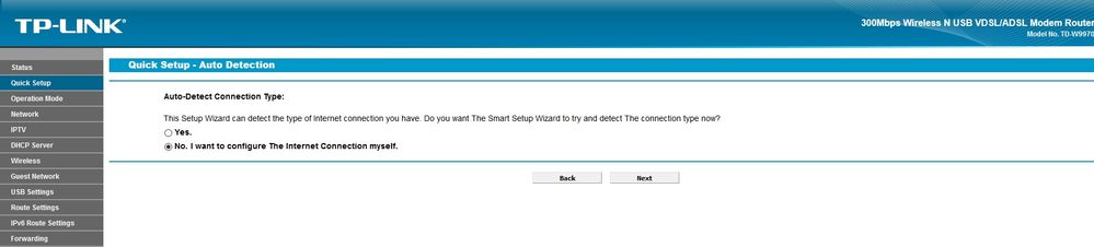

Go to solution
See screenshots below from emulator for steps to take.

So when I click on connection type do I click on "other" then "bridge" then vlan id 101.
Yes, 'other' is at the bottom of the list of ISPs.
