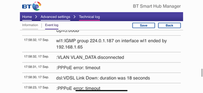

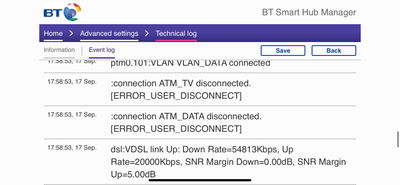

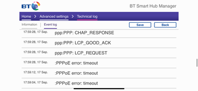

Hi,
Recently over the past three weeks or so I have been experiencing dropouts with my broadband. Checked my router log and seems to be “PPPoE Timeouts” had this problem before and had an Openreach engineer come to the property. He identified the issue was outside the property and nothing to do with the master socket or oxidation/corrosion on the metal prongs. The issue was something to do with the wiring outside the property.
Any recommendations?
