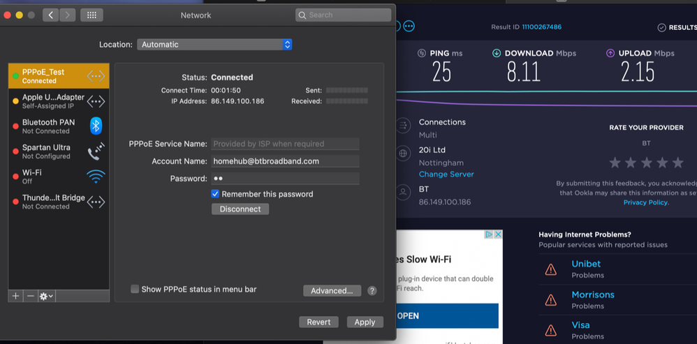

I have just hard wired to the Switch and run a Speed Test just via Google and the same speed was experienced, 3-7Mbps. I have also as recommended on Ubiquiti changed the MSS Clamping from Auto to Custom 1452, and this hasn't made any difference. I tried connecting via PPPoE from my Macbook to the LAN2 of the modem and it couldn't establish a connection.
1. Does anyone know why this drop in bandwidth has happened? (I haven't yet experienced necessarily any issues with bandwidth when streaming)
2. Correction to this point of not being able to establish a PPPoE connection, I was able to get a connection, using LAN1 of Modem, and then ran a speed test, achieving the same lower results as previously experienced. Please see below.
2. Could the issue be a FW on the Modem? How do I connect into the HG612 Modem using a Macbook to check perhaps if this is the problem.
I've called BT and they cannot help any further so anyone else who has established this connection, or got around any issues that I'm experiencing I'd appreciate the advice.
Connected directly to Modem from MacbookConnected directly to Modem from Macbook

Hi, thank you. I’m not sure this is the case. I’ve run a test on both the Modem and the BTHub and both are showing Downstream/Upstream figures of below 10Mb. BT have now finally confirmed it looks like the exchange started the DLM process and there could be a fault on the line somewhere as they said the bandwidth has been reduced since mid Feb.
not sure if I mentioned or updated the original post but I managed to get the PPPoE working from the MacBook to the modem.
thanks for your reply.
