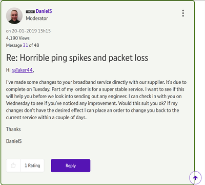

Is this the most under rated post on BT Community of all time?  i.e. do you just need to ask for "super stable" option to be applied to your connection!?

https://community.bt.com/t5/BT-Fibre-broadband/Horrible-ping-spikes-and-packet-loss/m-p/1916928/high...
Have just returned to BT after having persistent packet loss issues, i left BT because of jitter and packet loss issues more than a year ago but got worse with other ISP.     now have a healthy connection but not sure if i have "standard", "stable" or "super stable"  connection - not sure how to check.
