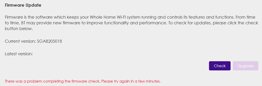

Keen to try this out, but unfortunately, I can't get mine going (tried via web, app, factory reset & various reboots):

First reboot you system, give it say 10 mins to all come up and settle down, make sure you have early adpoter enabled and then check firmware then it should display it and press update.

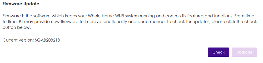

Turns out my ISP (FibreNest...) cannot reach the BT update server (done some googling and found to be 207.71.32.159). Probably due to their horrible Carrier-NAT configuration (hence why I'm so keen to get this update for IPv6). Anyways, I managed to bridge my phone's 4G which is on the BT network to the hub and update the firmware that way and it's all looking good with IPv6 and everything all singing and dancing. The lengths I have to go through lol.Screenshot 2021-08-02 130318.png

Glad you sorted it, i am assuming you are unable to ping that IP? Have you tried different DNS server addresses?

Yeah tried different DNS, can see it resolving the IP, but can't reach it:
Pinging dbtsu.bt.motive.com [207.71.32.159] with 32 bytes of data:
Request timed out.
6,466 Views

Have you tried it over a vpn? That should then resolve the FQDN.

Yes, I suppose that would be easier than tethering my phone. However, it looks like they've changed servers with the latest firmware anyway as it will now check for updates just fine.
