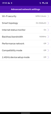

Kev2021, out of curiosity, how do you set back haul at 160mhz? I only have the premium white discs so perhaps it's a grey disc feature only.

It's under advanced settings, but I've never seen discs show backhaul reported as anything other than 80MHz regardless of the setting.

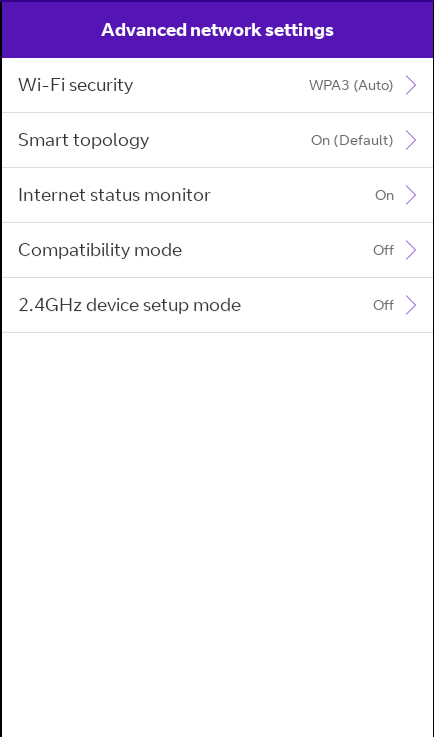

Thanks for that. Strangely the 160Mhz setting is missing in my options. Just updated the app to the beta version as well. Bizarre.

@BforBen , the 160Mhz setting only seems to apply to the dark grey wifi6 discs, the white premium discs stay at 80Mhz as you correctly pointed out, so you’ve no issues here.
