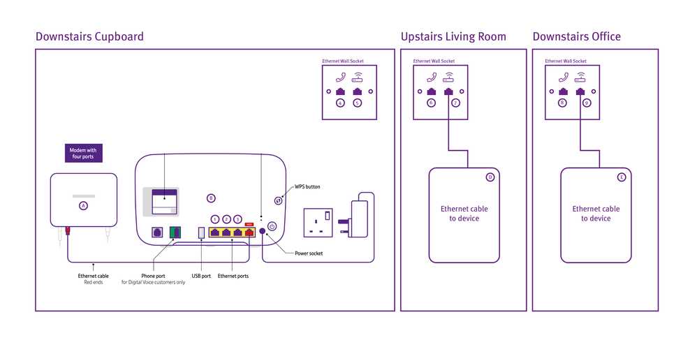

Hi folks, I've recently had BT Fibre 900 activated in my new place, but I'm new to Ethernet wall sockets which we have in most rooms. I've illustrated my current setup below; Am I right in thinking it's as simple as connecting the BT Smart Hub 2 to the wall socket via an ethernet cable (i.e. connect the ethernet port labelled number 1 to the data wall socket number 5) to give data to the whole house?

What you have described would not work or rather it would only feed one of your rooms.
Think of each socked as just being a direct cable from the hub to your device. One cable can not feed two devices without there being an Ethernet switch in the system.
You would need to connect one of the hub's Ethernet ports to feed the Upstairs living room and another of the hub's ports to feed the downstairs office which going by what you have posted there are not enough Ethernet wall sockets at the hubs end to allow this.
There should be an Ethernet board with multiple Ethernet ports. This would normally be where all the cables terminate possible in a cupboard near to where your "master socket" is situated. Once you find that you would then connect the hub's Ethernet port's to the boards Ethernet ports to feed each room.

Ah, I only have the little double sockets as illustrated (with one ethernet-style port labelled 'phone' one labelled 'data') in both the cupboard where the open reach enters the property (where the router is situated as illustrated) and in all the other rooms. There's no switchboard style thing.
So going by what you're saying I could do what I suggested, but only have one of the 'other room' devices connected as opposed to both? The rest would need to run off wifi?

@willhowe wrote:
Ah, I only have double sockets as illustrated (with one ethernet-style port labelled 'phone' one labelled 'data') in both the cupboard where the open reach enters the property (where the router is situated as illustrated) and in all the other rooms. There's no switchboard style thing.
Yes but that is assuming that the Ethernet socket that is beside your hub actually goes to one of the other rooms.

Thanks so much, we definitely don't have that - so maybe it hasn't been wired correctly - I guess I'll need an electrician to come and check things out and potentially add somthing like that to the cupboard. I'll try connecting one device and see if it works in the meantime.

In the end a Network guy came and assessed the situation. It looked like although the house had been setup to the use these data points an ethernet switch to control them all had never been installed to control them all. It did turn out that the 'phone' line was the only one wired into every room as a daisy chain, so we could at least use 'one' of the data sockets if required. We've since used this to run ethernet up to the top floor where there is a plug-and-play ethernet switcher up there for the most important 4 devices in the house and it all works fine.
