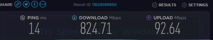

I guess I should have been more patient and let it settle?
