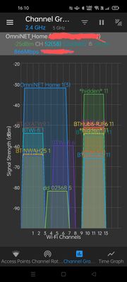

screenshot 2:
Here things are more interesting... It's so called 5 GHz "A" band, where, most of broadband routers using channels 36.42 and 48 (that bunch of chaos on the left of it). This will be probably also your situation as you compete with many many other Wifi routers over channels 36-48, lower part of band "A".
But, You can easily see, as my own WiFi router is alone on higher part of the band. unfortunately BT SH2 is NOT capable to go there, and that's what I using as my advantage.
While on lower part of band "A" is really big congestion (you might tell that even You don't have too much knowledge, just from that screenshot), no one is on channels 52 and higher... apart me... Here I am getting up to 450 Mbps download speed over wifi, in better moments up to 550 Mbps. Channel is for purpose set as 80 Mhz (combination of 4 single channels), to hold speed.
You might see here "866 Mbps". Again, it's maximum theoretical speed of the link due capability of my mobile to handle max 80 Mhz bandwight.

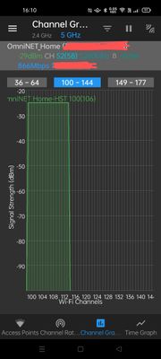

Screenshot 3:
This is 5 GHz band "B", and You don't find it on BT SH2 at all. In the fact, you don't find it on majority of WiFi routers, whilst most of them are "two band (e.g. 2.4 Ghz + 5 Ghz)" only.
My router is "tri band" (e.g. 2.4 Ghz + 5 Ghz + 5 Ghz, with coverage of band A and band B).

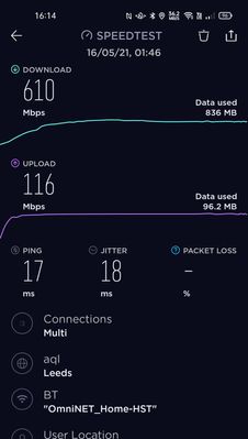

As you can easily see, again here is 866 Mhz theoretical maximum through trout speed, and no one, whatsoever around me. This giving me total advantage. Speed test, which you see above is made on this, and You might see nice 610/116 Mbps down/up OVER THE WIFI...
My hard wired computer at same moment gets 820/119 Mbps down/up. It will always benefit from better speed as any of WiFi devices, just because it's hard wired.
