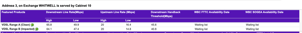

what you posted shows FTTC at the address but you have cut of the rest which would show available or waiting list.  if waiting list that would explain why FTTC not available

In the info you chopped off, was there any mention of 'Waiting List' ?
Sorry it's taken ages to respond have been out helping another friend.
This is what I see for my friends address, it does say waiting list at the end.  I have checked other properties on his street and they all also say Waiting List at the end.  However all of them are able to use a Fibre connection and if you use there details on the BT website for example it says they can have Fibre between 40 and 60Mbps.

If they already have fibre it's not a problem. It means the cabinet is full and there are no spare ports for any new customers. ADSL comes from the exchange rather than the cabinet.
Nothing to do with incorrect records and a you can do is keep checking for the checker to say available.

I'm a little confused as all his neighbours show the same as waiting list?  They also show connected to the same cabinet. However some of Fibre and if you enter any of their details into BT for example it shows they can have fibre.  Shouldn't they also have to wait until it says available?

There are no spare ports in the cabinet, ergo it will show as waiting list for any address put in the checker. Anybody already having fibre is clearly not affected by the lack of ports. If you put a BT number that has fibre in the checker, it will recognise that the number already has fibre and the status is irrelevant.
