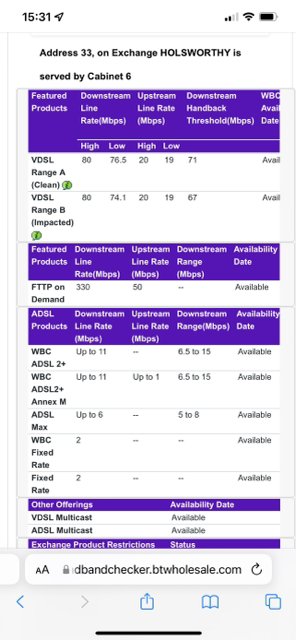

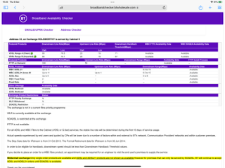

I have checked the Openreach website but it wont allow me to attached an image as its over the file size limit but the top two lines show
VDSL Range A (Clean) High 80 Low 76.5
VDSL Range B (Impacted) High 74.1 Lowe74.1

Forgive me but, where does it show that my attainable speed is only 52? This is less than the BT website advertises and that dsl checker shows higher than that with my address

Screenshot is unreadable, too small.

Sorry but if I go up in size it wont allow me to submit it as too large apparently. I am trying to figure out a way to get around this.
