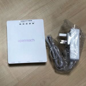

FTTP - fibre to the premises as against FTTC - fibre to the cabinet - and then copper to your home
if you have FTTP you will have an openreach box ONT similar to this
