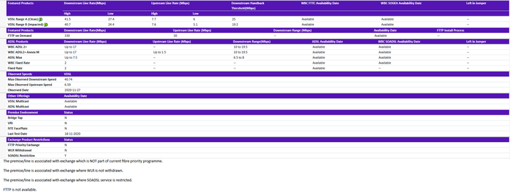

I've tried the quiet line check and it was suitably quiet 🙂
Here's the output from the BT checker.
Thanks for the advice/support

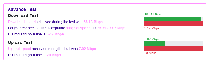

Hi,
Sorry I should also have posted this - the output of the 'advanced' test from the BT checker which seems to confirm that what they consider 'acceptable' has reduced.  Unfortunately I have only just discovered this tool by looking on this forum when I first noticed the slowdown as so can't say what it was when we were getting the higher speeds.

the dslchecker estimated range 41.5/27mb and  looks like you have a 40.7mb connection speed which is right at top end.  your download speed is consistent with your connection speed.
can you post any stats from vigor?
