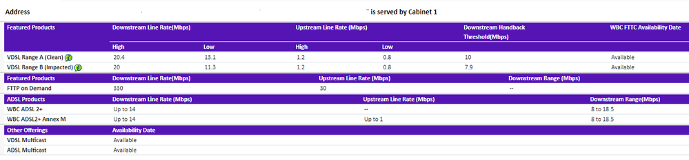

Re: Requested FTTC But Speed Estimate Lower than Current ADSL
The engineer called me when the connection was made to the cabinet last week and told me it was cabinet 1. Cabinet 6 is the closest to me. I'd already informed BT and openreach that moving me to that cabinet from the exchange was a pointless effort due to the distance. What specific questions can i answer that will assist, i'm afraid I only know the facts as I've been told them by openreach engineers so don't know anything first hand.

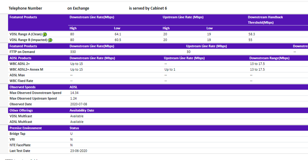

can you enter your phone number instead of address as that is more accurate and repost please
The main thing to establish is whether your neighbours are connected to cabinet 6 and if they are connected to the same pole as you. All customers in the same cable will be connected to the same cabinet therefore if you are all connected to the same DP (distribution point) you will all be connected to cabinet 6.
The key question is are those 2 properties served from the same pole?
When you talk of neighbours, do you mean immediate neighbours or are you in a very rural area and some distance from other properties.
Looking at the checker figures, you must be fairly close to the exchange to get 21M on ADSL, the other number must be quite a bit further away as they only get 14M.
I rather suspect that cabinet6 is not between you and the exchange but further out and your neighbour's circuit is routed out toward cabinet 6 whereas yours routes in the opposite direction to cab 1 outside the exchange.
2,781 Views
Message 16 of 17
You right about the geography. We are 2km from exchange, and 300m further down the road are the nearest neighbours with cabinet 6 outside. We are thus between cabinet 6 and exchange, which i why i asked at the time cabinet 6 was being installed if we were to be connected. Best download speeds in practice are closer to 15M, although drop outs kill off the connection a few times a day. Cabinet 1 is right outside the exchange.
