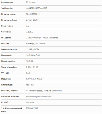

In June this year i had a dlm reset and since upto 2 weeks ago everything was running great, then i noticed the upload speed had dropped on the router status page to 800kbs, download speed was listed at 60mbs but i was never reaching this, speed test would come back at an average of 35mbs down and 700kbs up.  So i switched routers, from a TD-W9970 to a BT hub 6a which was sent to me in june with a new contract.
I have checked all internal wiring and everything seems to be fine, i have removed the faceplate and i'm in the test socket currently(with a filter), speeds are continuing to degrade, i am currently on about 25mb down and 700kbs up, i raised a fault 2 days ago with the automated diagnostic on my bt:-

My hub:-

your down connection speed looks good at 60mb and well within expected range but up speed is terrible.  as quiet line test ok and already connected to test socket I cannot see what more you can do    you need to phone 150 and get engineer visit

Thanks for the reply, it states 60mb, but:

Your upload definitely look wrong at 0.8Mb when the attainable is 15Mb+, , if you are in the test port and possibly using a different filter, then really all you can do ( if the fault is open ) is wait, or contact and ask what the progress is, what was discussed when you reported the problem ?
