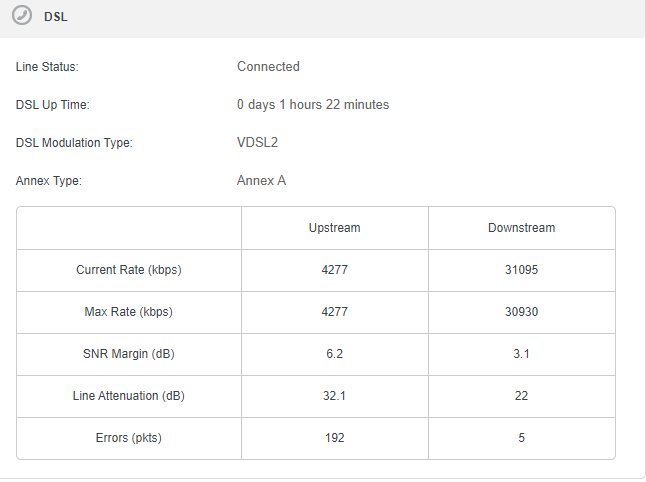

My router conducting a speed test (via speedtest.net / google) is reporting precisely 25mbit down and 1mbit up. These don't match the line speeds reported by the router, which are below:
Quick edit:
I know the noise values here aren't ideal. But I've been getting 50mbit for years with zero issues. The only thing that's changed is the router bricking and causing a ton of disconnects on trying to fix its firmware. Also this is a new router obviously, but I can't see any reason why it would reduce bandwidth by 50%. It's an Archer VR2800 if anyone has any ideas there.

Of course not, download speed will always be lower than sync speed due to protocol overheads. Looking at your stats, you have a 3dB noise margin, therefore DLM is perfectly happy with your line and hasn't reduced your speed. you are getting your maximum speed possible.
