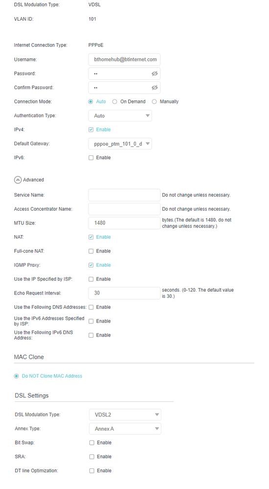

Does anything here look wrong:

You could try setting DSL Annex type to Annex B to see if that makes any difference.

Sadly only Annex A is available in VDSL mode.

Annex A is correct anyway, just something to try.

The username is normally
[email protected]
