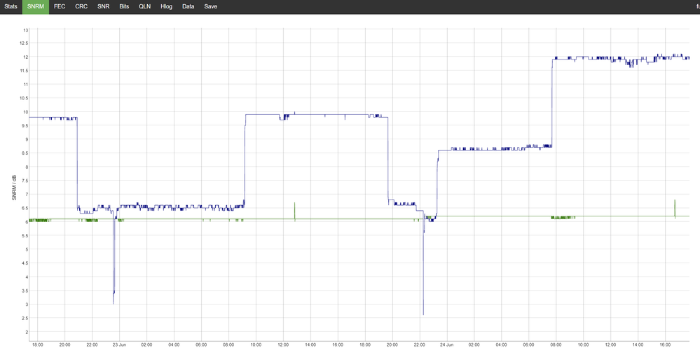

....oh dear... i seem to have been too quick to assume I had discovered the problem.
seems its not my cordless house phone at all.... it was just a coincidence that the SNR dropped at the same time i disconnected it to test.
I even bought new phones, same problem. I bought a new complete nte5c mk2 and MK4 faceplate, same problem! Tested the silence test, clear as a bell.  And im still getting occasional line drops , 1 a day usually...
SNR is still up and down. It can go as low as 2 and high as 12! (highest yet today?) That cant be within normal expectations surely ?
Anything else I can try ??

Re: SNR like a roller-coaster ? - help
Normally your noise margin should be static with maybe fluctuating by +/- 0.1db
Do you have any extension sockets. Did you check there was no dial tone when you connected to the test socket?
It certainly looks as though there is some sort of interference coming and going at those times. Its weird that the noise margin increases rather than decreases though as though the interference is there most of the time and then goes off for a while.

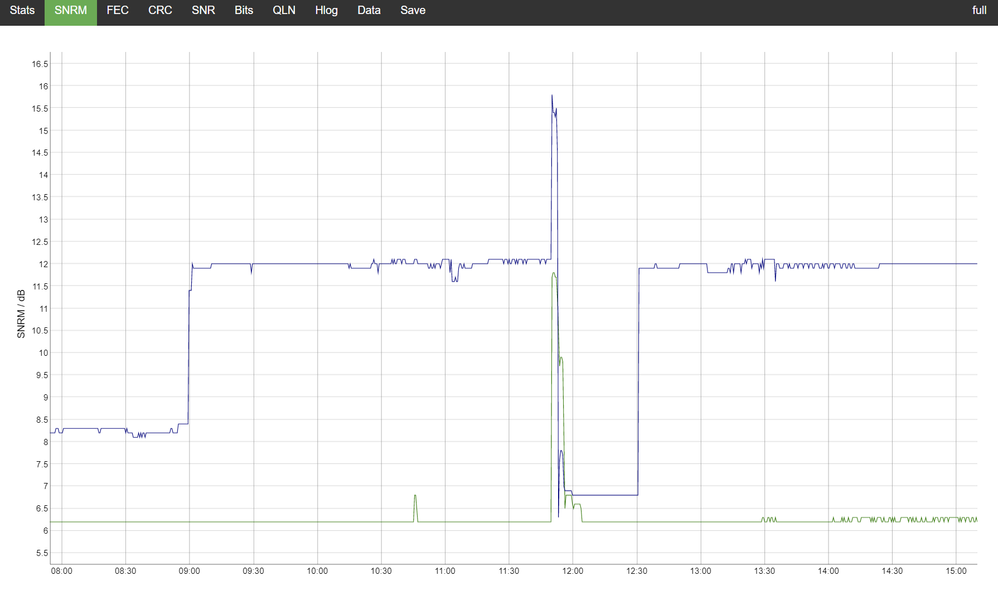

thanks, but it does affect it,
1. it drops the line almost daily
2. my line speed rises and falls by roughly 10Mbps in parallel to SNRM
also, does it make any difference whatsoever if you make the modem handle the PPPoE , or the Router ? I ask because i seem to automatically lose another 10Mbps from modem to Router when letting the Router handle it...

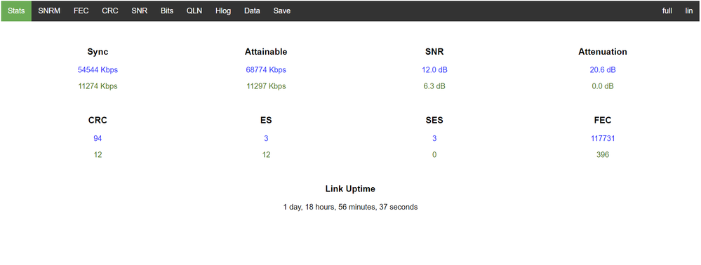

* there must have been an epic Solar Flare this am just before 12 noon ? Quite a spike on both Up and Down...followed by a weird drop (flatlined also?) maybe line died for a while, not sure...I was at work.
Current stats , just now 17:15 25-6-2021
