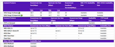

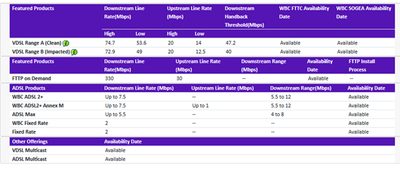

Interestingly, checking out the rest of the flats in the same building our neighbours are typically getting 37Mb stay fast with vastly faster max speeds.
Using the BT wholesale broadbandchecker I found out that all the neighbours and us are connected to the same exchange, Southside cabinet 16.
Again though, the speeds recorded for this flat seem significantly lower and half of what is reported on the broadbandchecker.
Speeds for the other flats in the house, same cabinet

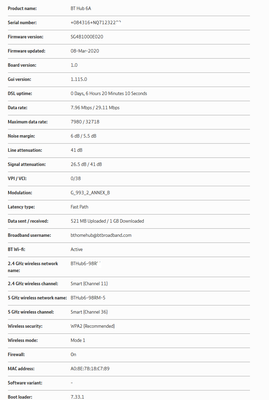

In case you needs this bit of information I have also attached the router readout.

Just because it says they could get those speeds it doesn’t mean they are.
3,026 Views
Message 3 of 5
Re: Same Cabinet for entire house, all neighbours 9mbit faster stay fast guarantee?
As usual correct @Starwire  wouldn't expect anything else from you!  A phone number check would provide more info as there would be the last observed speed listed also.

Turns out, somehow our telephone line doesn't give a signal when you connect a handset to it but internet works. Got an engineer come in tomorrow. Maybe this was causing the issues.
2,949 Views
Message 5 of 5
Certainly will be, broadband will work very slowly with one wire disconnected but the phone won't.
