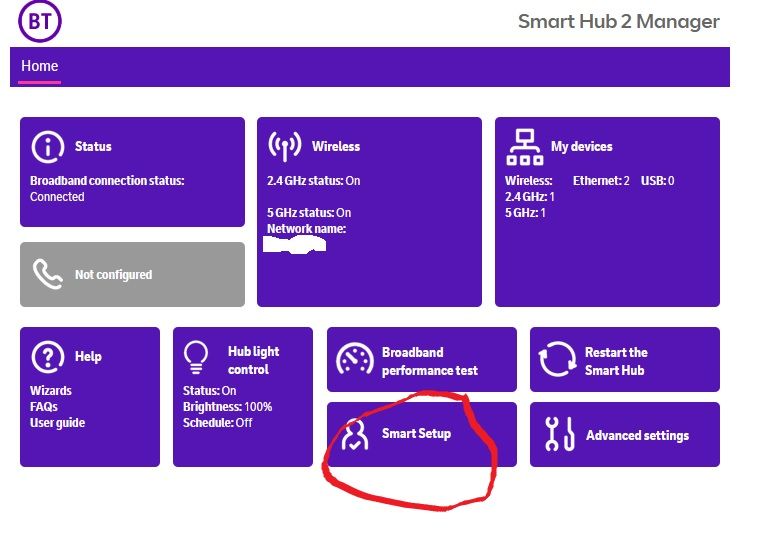

Hi,
I appreciate this has come up before, but we have the problem of our Sky Q box disconnecting from the network every evening. I have tried many of the fixes suggested but one thing that seems to work for many people is switching off the smart setup on the hub. I have tried to do this but I can’t find where the option exists to do that - has it been removed?
Any help or suggestions would be much appreciated. Thanks I’m advance.

Re: Sky Q problems / smart setup
have you turned of smart setup
Turn Off smart setup
I would also change the 5ghz network channel to manual from auto and select another channel to channel 36 which is used by SKYQ - try 44 or48
Thanks for the reply. I’m just not able to see the smart setup option in the hub manager and that’s why I was wondering if it’s still there?
thanks for the other suggestion, will try that.

which hub version do you have?

It’s a smarthub 2. Thanks so much for the help.

Still there

I’m going to try firing up the laptop as I’m not getting that option on my phone! Thanks

Yes that worked - that option just wasn’t showing on my iPhone but it was there when I connected on the laptop. I really appreciate you helping me out, thanks very much

Go into wireless devices and assign each one to have that IP address permanently. DCHP leasing is for a 24hours by default,. this cause an issue whereby the mini boxes keep looking for the main box
