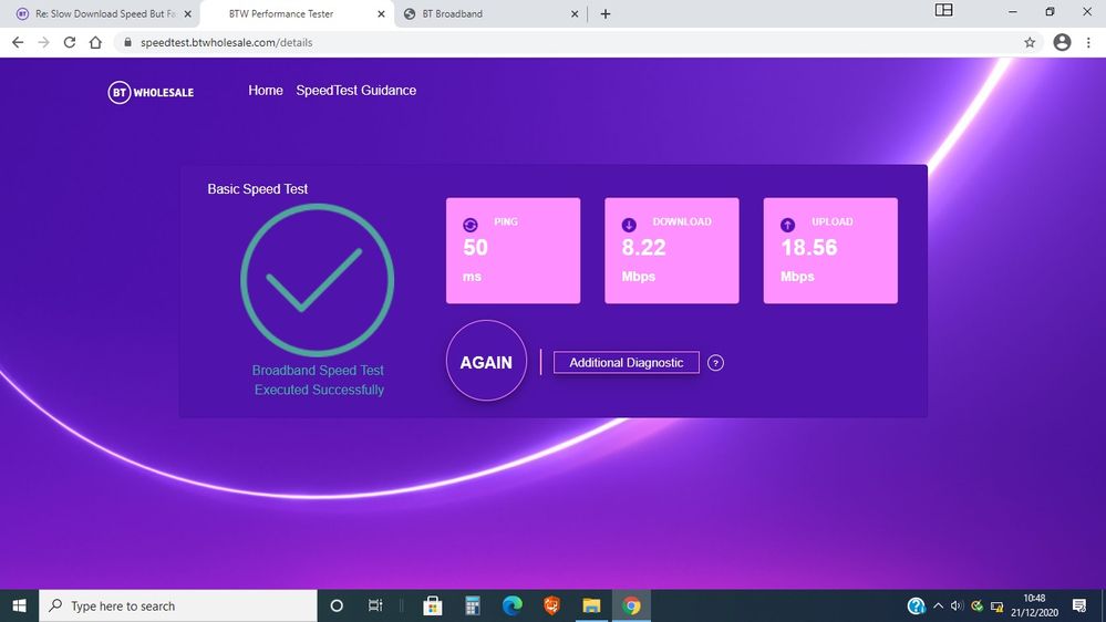

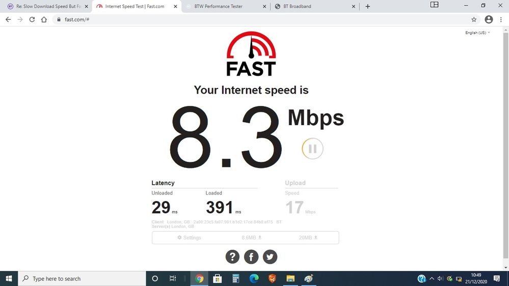

Hi imjolly
Thanks for getting back to me, here's the results of the speed tests.
I'm just trying to reduce the size of the adsl checker as it exceeds the file size limit.
I'll send this one over once i've got it under the file size limit.

Re: Slow Download Speed But Fast Upload Speed
Are those speed tests via wired or wireless?
Sorry these tests were wired.
