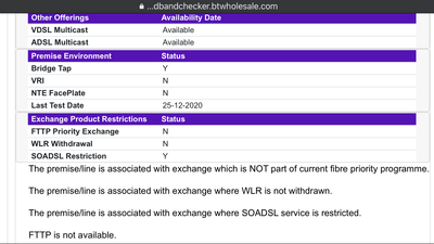

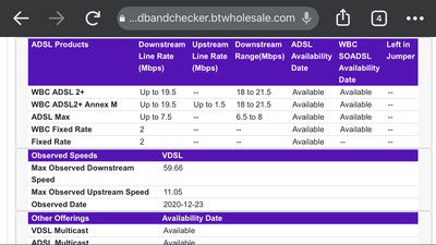

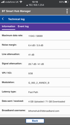

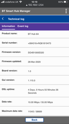

 please can you post the stats from your router (if hub enter 192.168.1.254 in your browser) and if  HH5 then go to troubleshooting then helpdesk and if HH6/SH2 then advanced settings then technical log information .

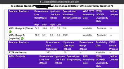

enter your phone number and post results  remember to delete number   https://www.broadbandchecker.btwholesale.com/#/ADSL

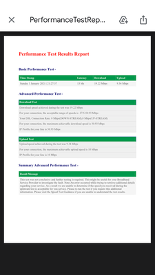

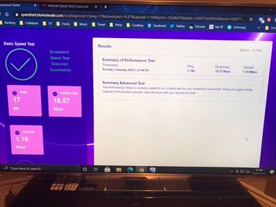

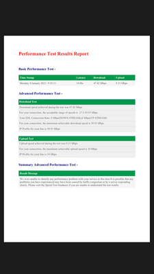

run btspeedtester and post results  must be done with ethernet/wired connection not wireless   do when speed ok and then again when you think poor and post results
https://www.speedtest.btwholesale.com/
Someone may then be able to offer help/assistance/suggestions to your problem

Hi and thanks for replying, here’s the data you requested.

New router arrived today. Swapped them over and having same issues tonight, speed dropped below 10mb consistently between 8.30-9.30, its gone up to 18mb now at 10.30. Ive tried moving router to a different position which didnt help. I then tried removing debices from my network one by one til i eas just left with my desktop connected via ethernet, made no difference to the speed its still sitting around 15-20mb.
