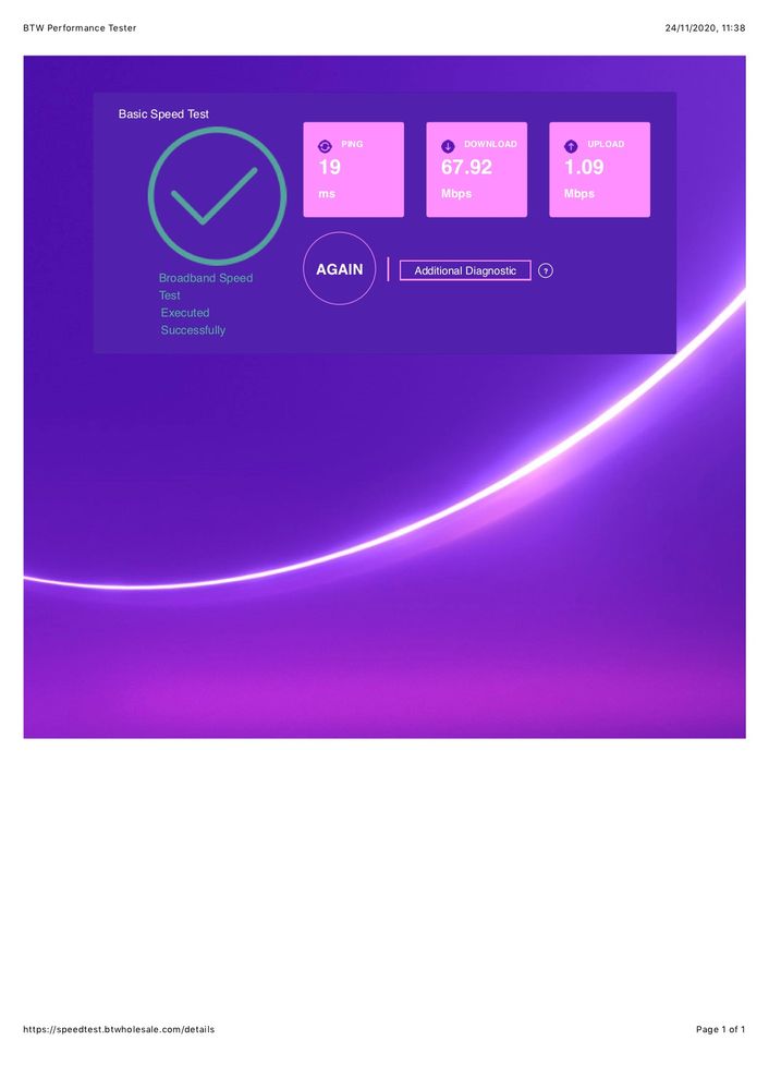

sorry I also saw you wanted the results from the checker, see below Also interesting notes about FTTP as we are getting FTTP in the next couple of months. As mentioned earlier Openreach recently installed fibre to the top of the  telegraph pole and now just needs the last overhead fibre run into the house, so I'm hopeful that it will happen soon

Obviously btspeedtester is having problem but that is not unusual
your connection speed is very good and with noise margin down at 3.3db the DLM has already decided your line good and reduced noise margin from normal 6db giving a boost to connection speed. 17mb download speed is also good for your 20mb connection speed

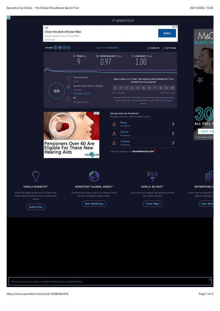

So service performance has dropped through the floor, often no service or very poor. Speed testers including BT wholesale often won't load. Messaged BT fault finding to get the response "there is no fault". So the fault then must be either at the exchange or further into the BT core.
Might be related to an internet flood as lockdown tiers were announced but there should at least be some service. Here are a few attempts to run speediest2020 11 26 13-11 BTW Performance Tester.jpg2020 11 26 13-20 speedtest.jpg2020 11 26 13-21 speedtest.jpg2020 11 26 13-23 BTW Performance Tester.jpg2020 11 26 13-27 BTW Performance Tester.jpg2020 11 26 13-32 speedtest.jpg

I didn't try fast this time but I have uploaded some tests from BT wholesale and speedtest. I didn't try fast this time, sorry. But speed was either zero or very low, less than 1mbps. As mentioned bt fault finder has responded at the second level to say no fault so I have requested a call. Now the speed is back to normal. I did try the following trace routes to google and BTs speediest sight. Here are the results. I'm thinking the issue is either at the exchange or more remote. You can see some lengthy responses in the trace routes up to 120ms.....
