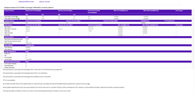

your connection speed is about the same now as it was on 16/10 before the firmware update  it is also well within your expected speed range

Ok thanks yeah I can see that says 22.66 observed on the 16th, and I'd expect some fluctuation in results.
However I do usually get a solid 25/25mb and have done for the 2 years I lived here. The 19mb I am getting now on every single test (whether that is due to firmware or not) is a fair amount lower than my norm.
I realise BT have their stay fast range but I posted here as I hoped someone could help explain the sudden drop. Granted the firmware could be a red herring although I do now see other posts with people posting similar issues after this firmware upgrade earlier in the year.

but as can be seen from dslchecker results your speed is the same now as it was before the firmware update so the firmware update is a red herring as far as your connection speed is concerned

I think you might be  missing my point.. I'm also not convinced the firmware made any difference but what I do know is prior to the firmware and subsequent reboot I got a solid.
25mb
now I get
19mb
Somethings changed I dunno what, thank you for your help though your troubleshooting steps were helpful but my original issue remains.

sorry to labour this but your firmware update was today but your speed on the 16/10 is the same as the speed currently shown by your hub stats so how can firmware be the problem if speed just the same before and after
