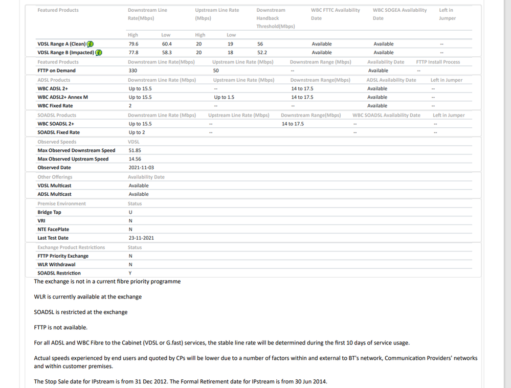

enter your phone number and post results  remember to delete number   https://www.broadbandchecker.btwholesale.com/#/ADSL

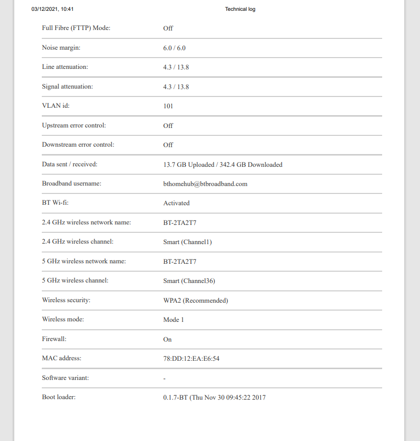

@imjolly  Sorry I feel stupid but i have the information you requested however it is saved as pdf and i am not sure how to get that into the forums?

Re: Slower Speed than expected
Think i sussed it... This is the info requested (I hope!)

Can you post the top half of the information page?
