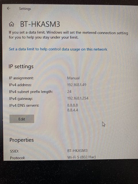

Set the DELL as below

My manual IP setup looks slightly different, but I got it working with Subnet Prefix Length of 24
You can see the hub's device list showing the various IP addresses. It's super annoying and difficult to add some devices as you can imagine, and it seems the only option is to set a static IP forcing the device to 192.168.1.xx
