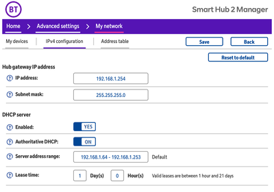

I don't see any reason why it should not work. In fact, I used a Netgear GS108 switch for a few weeks on my SmartHub 2 until changing it for a GS116. Both work fine.
There are not many user changeable settings on the SmartHub2 when it comes to the LAN, so there's not really anything I can think of that you are doing wrong. You can see my settings below, if it helps.
Someone more knowledgeable may be able to provide more ideas. I just wanted to let you know that I use Netgear unmanaged switches and they do seem to work fine, so it shouldn't be a general issue.

My settings are exactly the same.
