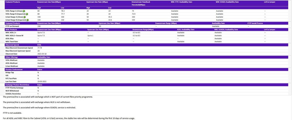

enter your phone number and post results  remember delete number

Ok, that would indicate that you are getting G.Fast which means that your current arrangement won't work.
