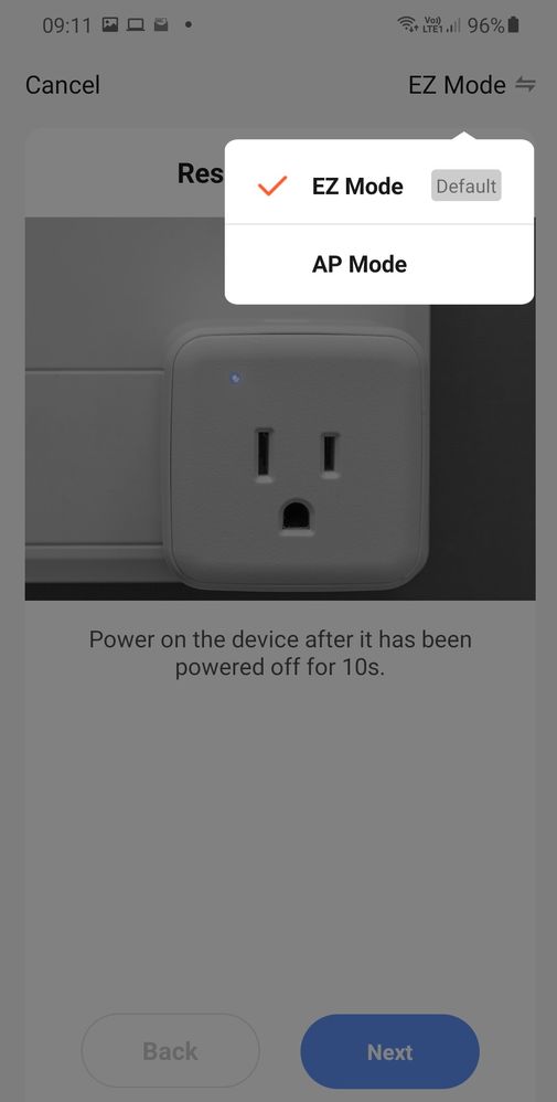

I had plenty of issues trying to connect through EZ mode - don't think it ever worked.  Have you tried using AP mode to configure the plugs.  There's an option in the top left hand corner that will allow you to switch the pairing mode.  You then connect directly to the device and the app configures it that way.  Hope that helps.

Go to solution
That did it, thanks so much!
