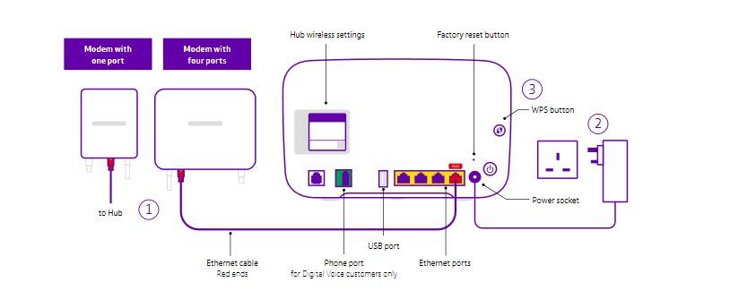

A picture explains it all.

Those are the instructions I'm reading. If I do that (red cable from the small white box ( that also has the phone plugged in in a seperate socket ) the hub doesn't work. I also have a large  white box (which may be a huwai hub) and looks like:
That has a cable going to the small box and a grey cable going to the hub. That's the cable that allows the hub to work. Note all the five lights along the top are green one is not  lit.

It does not have to be a red ended cable. If its a grey one plugged into the optical modem, it works just as well.

I haven't connected the red ethernet to the phone line, Its plugged into the socket that says broadband next to the plug that the phoneline is plugged into that says phone. There is also a second box that has a grey cable coming out of it but no other obvious plug sockets - But there is a front cover that comes off, I'll have  a look when I get home. Set up in the same way as BT set the old hub up and it works .
Of course, that's how it should be set up.
Your broadband is delivered by fibre not copper. The 'broadband' socket on the small white box (NTE) is no longer used as you have fibre.
No idea why there is a cable from the ONT to the NTE.
