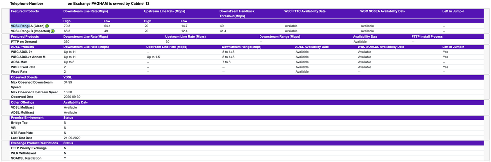

However, I never see anything over 40Mbs, in fact after doing the check here https://www.broadbandchecker.btwholesale.com/ I can see the max I've seen is still under 40:
Now I do understand that there's some small print to all the speed estimates etc but should I be expecting to be able to get more the 32MBPS which is what I've been getting for months now. I'm also not a million miles from the Exchange or Cabinet, pretty sure the cabinet is quite literally a stone's throw away and the exchange is a 2min walk.

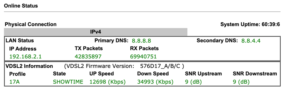

I've checked the line using the 17070 and all is quiet, I've also checked the line by connecting up to my Draktek Modem:
Just intrigued to know what options I've got, because right now it feels like I'm paying for something capable on paper (or BTW/BT info) of twice what I'm actually seeing.

It  looks suspiciously like DLM has banded your line at 35M due to instability.

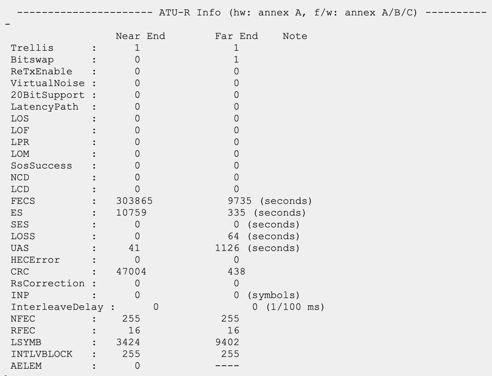

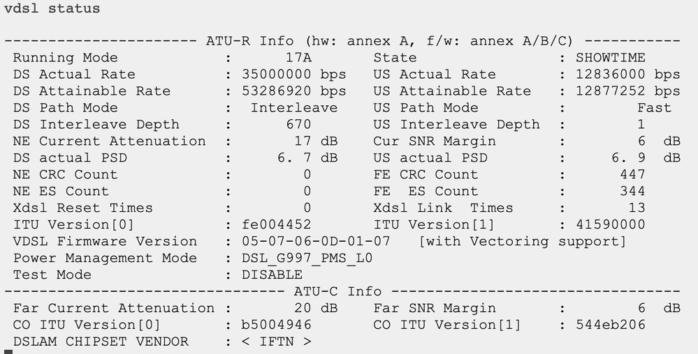

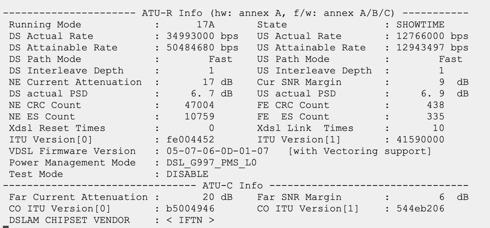

After spending a bit more time with the modem I found a little more line info:

There is still nothing in the additional stats to show your internet  connection time.  Have you been  having problems with your modem dropping connection as that would account for the drop in connection speed and increase in noise margin and ending up in a banded profile

In looking today, the SNR values have dropped from 9 to 6.

...as well as SNR, Path Mode has changed today.
