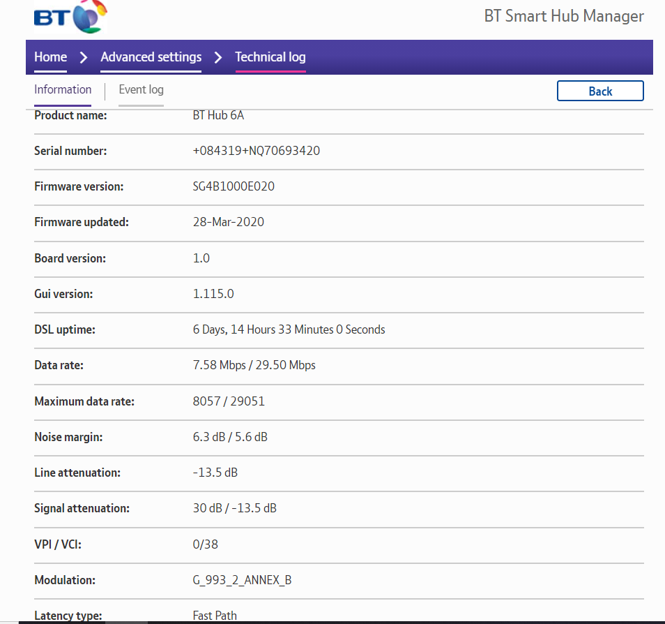

in order for the forum members to help please can you post the stats from your router (if hub enter 192.168.1.254 in your browser) and if  HH5 then go to troubleshooting then helpdesk and if HH6/SH2 then advanced settings then technical log information .

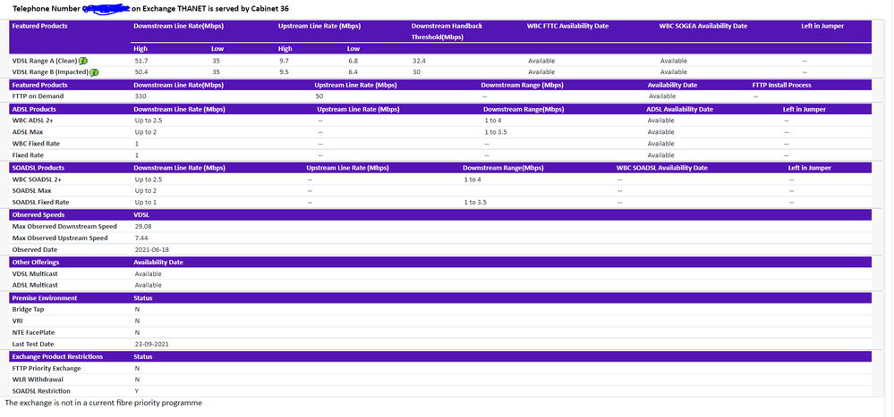

enter your phone number and post results  remember to delete number   https://www.broadbandchecker.btwholesale.com/#/ADSL

Re: Speed dropped after fault repaired.
2,628 Views

Any line noise is a problem. I would check from the test socket which is behind the master socket faceplate and if still static noise then report phone fault to 151
Looking at your stats your actual connection speed is at the max attainable speed leaving no scope for increase. Are you currently using the test socket to see if that helps speed
