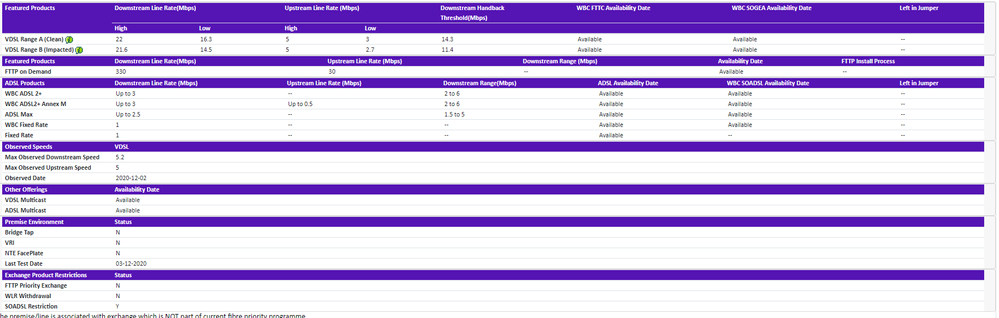

Personally, I don't know what I am looking at here. But here is a screenshot of the DSL checker.dsl checker.PNG

@zibbitty
Is your phone line working, as your speed is well below what is expected, even the last observed speed is low.
That is normally caused by a disconnected phone line with no dial tone on it.
Plug a phone in and see if you get dial tone.

the phone line is working fine, however using a landline, there are occasional bits of static through the dial tone.
Then that is probably the cause of the poor connection speed. A better check is to dial 17070 and select option 2. There should be no noise between the announcements.
Its  best if you check at the test socket first, before you report the noisy phone line, just in case its an internal fault.
What does your master phone socket look like?
