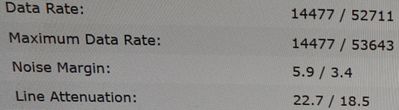

20210121_121303.jpgthats all i can fit without exceeding the file size. Its been a gradual decline in speeds would it effect my guaranteed speed tho? It seems odd that its lower and lower

 as you can see this is apparently my max speeds if everything works properly. But that telephone line checker says i can have 80? I used to be just off of 80mbps.

the checker results does not say you can get 80mb it shows your expected connection speed is between 80/66.7mb but from your stats your noise margin is at 3.4db suggesting that you have already had a speed  boost by the DLM activating G.INP
problem is usually caused by more people on your cabinet and crosstalk
