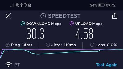

So... Overnight and no change. Speeds are still dipping up and down majorly. Openreach said they had done everything they could think of so before I call BT again, does anyone have any ideas? The speeds go up and down over a matter of minutes from 30 to less than 1. Last night we turned off all other plugs in the house to see if any devices or electrical interference is causing it and and it is still happening. Here are some screenshots of the differences in speed. Note the times in the screenshots, it is a matter of minutes between these dips.
Screenshot_20200604_095648.jpgScreenshot_20200604_095706.jpgScreenshot_20200604_095748.jpg
