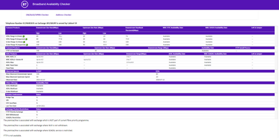

I have carried a broadband availability checker which confirms 330mbps down and 30mbps up, on Fibre 100 i regularly received as quoted by BT sometimes more.

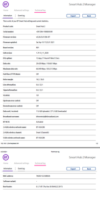

Can you post the connection stats from the hub. Advanced settings/technical log/information.
Can you confirm your set up. Is it wireless from hub to disc then wired to PC?

You were getting 330M down and 50M up on the 10th Feb

Well the checker shows the figures received by the hub as 330/50
The speeds guaranteed by BT are sync speeds, not download speeds.

Data as requested

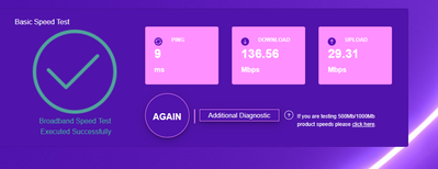

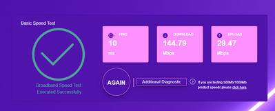

Tested wholesale twice at 18:35
