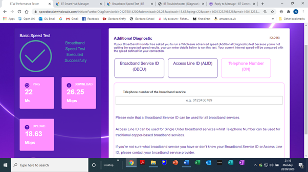

Hi - ran the speed test at BT wholesale but i can run additional diagnostic options without BBEU or ALID no - the phone no. option doesnt give any result. Pic of slow speed attached. If there's a way of getting the further diagnosis numbers please advise.
Thanks for the help

Did you try just entering your phone number?
3,142 Views
Message 5 of 7
Re: Step down and now huge variability in connection speeds
Yes-but got the same "test failed to run message, contact BB  provider " message you can see upthread on the example from yesterday. Also stated on website that the number only test works only on traditional copper supplies for some reason.
