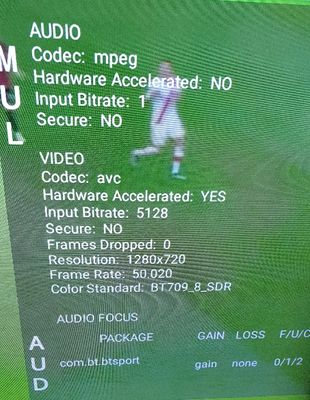

BT SPORT on my FireTV stick seems to be topping out at 720p50 and won't go to 1080p50.
I'm not having this issue anywhere else on other services (Now, Netflix ect) which are all running 1080p50 and 2160p24 straight away. Any known issues, or fixes I can run?
(Stick is the latest FireTV 4K and set to match framerate with 2160p output enabled)

When we launched BT Sport on Fire TV, we found that some devices were maxing out CPU on the 1080p50 stream (even though they should be capable of supporting it), causing jittery picture. We therefore capped the HD stream to 720p50.
I'm not sure if that cap is still there - I've asked the team to check, and see if we can restrict the cap to just affected device models.

I know this is an older thread, but I wanted to chime in on this, this issue is not just effecting fire TV sticks it's also effecting the fire TV cube 2nd like the OP I am also capped at 720/50 despite the fact that the box i more than capable of streaming at 4k 60. The cube itself is able to play btsports ultimate UHD perfectly at 60fps which makes it even more ridiculous that you're saying that the firetv device can have to be capped at 720/50 due to the CPU, please fix this  as soon as possible thanks I certainly would not say that this issue is solved

I would definitely recommend leaving your device configured with resolution: automatic. This allows the app to decide what resolution and refresh rate to use based on the content - e.g. forcing it to 60Hz will cause BT Sport (with it's 25/50fps content) to jump a lot. With it set to automatic, the app will switch to the highest supported resolution that supports 50fps.
As for removing the 720p cap on Amazon devices - this will come in our next app update, coming very soon.

I’m now getting the BT Sport channels on my Fire tv Stick 4K  with 1080p @ 50fps. Thanks guys.
