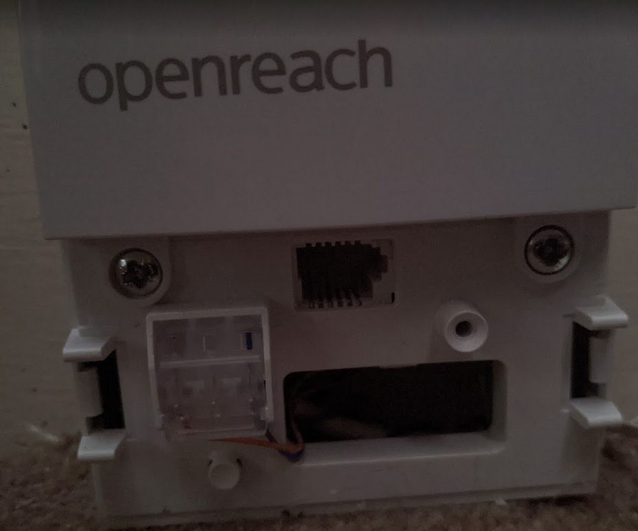

I assume you have nothing connected to terminals 2&5 beneath the blue connector on left of socket
3,711 Views
Message 13 of 20
Re: Sudden drop in conection speed and connection stability
It' a clear connector in this case and there is.
3,707 Views
Message 14 of 20
That explains why you cannot get connection at test socket as 2&5 under clear plastic is where any extensions would be connected whereas the main connection is on the back of that plate in terminals A&B. So when you remove the faceplate you disconnect the test socket

I can't believe the openreach engineer connected the socket like that unless you have something else connected as well mY e nearer wher the line comes into your home.
If there is nothing then if it was mine I would rewire the socket so the incoming openreach wiring connects to the correct terminals A&B on the back and see if that helps

There is another socket thats an extension of this one but AFAIK it was disconnected. The line in is on the outside of the same wall the socket is attached to.
I'd be tempted to make the changes you mention but I really can't afford to have even the limited connection we've got stop working if something went wrong.
