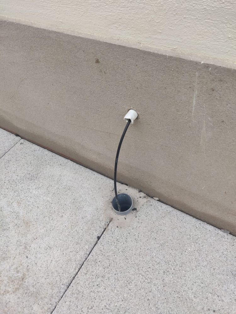

Message 25 of 33
Re: The nightmare of a new build and broadband!!
You got a picture of it?
4,253 Views
Message 26 of 33
Of what, the cable into the house, the hdmi cables or the box?
4,240 Views
Message 27 of 33
The cable into the house.
4,223 Views
Message 28 of 33
Yeah, the cable into the cable into the house.
4,206 Views
Message 29 of 33
4,205 Views
Message 30 of 33
my fear is that a) that hole in the ground, is begging to be filled with water and damage the cables underground. b) anyone could come with scissors and cut the cable. I spoke to an engineer this morning who told me indeed they give connector ducts to builders and they should fit me with one, so as they have to come in to fix minor details on the house, I've "added it to the list" sort of speak.
