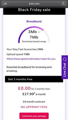

Hi I was wondering does anyone know if there’s anything I can do to get better broadband
The property BT says speeds between 3-7mbps with garuntee of 2mbps some providers that use openreach say I crnt get broadband and those that can are very low

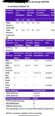

it looks like I’m unable to get FTTC but other addresses on the street can so I’m wondering can anyone help or advise if maybe there a problem with the availability checker
I’ve attached the detail on the checker that I seen on other posts

The cabinet is full, so there is nothing you can do until ports are available, you just need to keep checking.

Your street cabinet is full and has a waiting list for FTTC hence why you can't get fibre connection and best you can get is adsl2. If you currently get about 7mb connection that probably best you can get.  You need to keep checking the dslchecker and as soon as you see available then phone and place order for upgrade

With the checker showing ‘waiting list’ chances are no provider will offer you anything other than ADSL (7Mb because if the distance to the exchange ) or if they did take your order they wouldn’t be able to action it with Openreach, but it’s likely that the current occupant has FTTC with NowTV and that their FTTC port will  become spare when they move out , (advising Now that they don’t need broadband at that address should change the status to ‘available’.)
You could take ADSL initially and then almost certainly get a free upgrade to FTTC once the equipment is shown as spare , but obviously there may be more than just you waiting for a FTTC port to open up, or you could wait a few days until they have moved out , periodically checking and if/when the checker shows ‘available’ instead of ‘waiting list’ and get your order in then, obviously if someone else grabs the port you are not stuck with ADSL .
