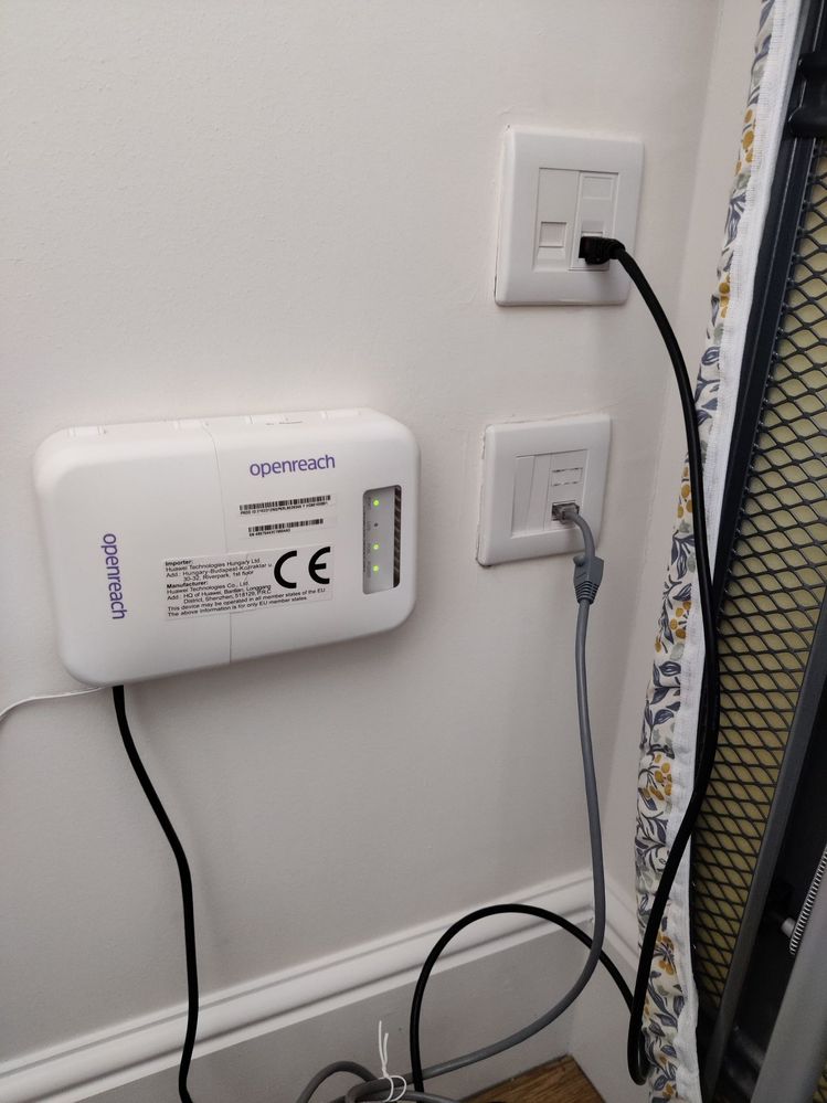

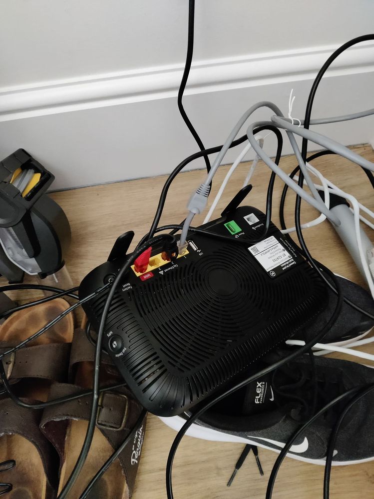

I've recently moved into a new build house and have set up my smart hub by the ONT.
I have the red WAN cable plugged into PORT 1 on the ONT, then I have ethernet ports 1 & 2 serving upstairs and downstairs.
The smart hubThe smart hubont box - grey cable for downstairs and the black cable for upstairsont box - grey cable for downstairs and the black cable for upstairs

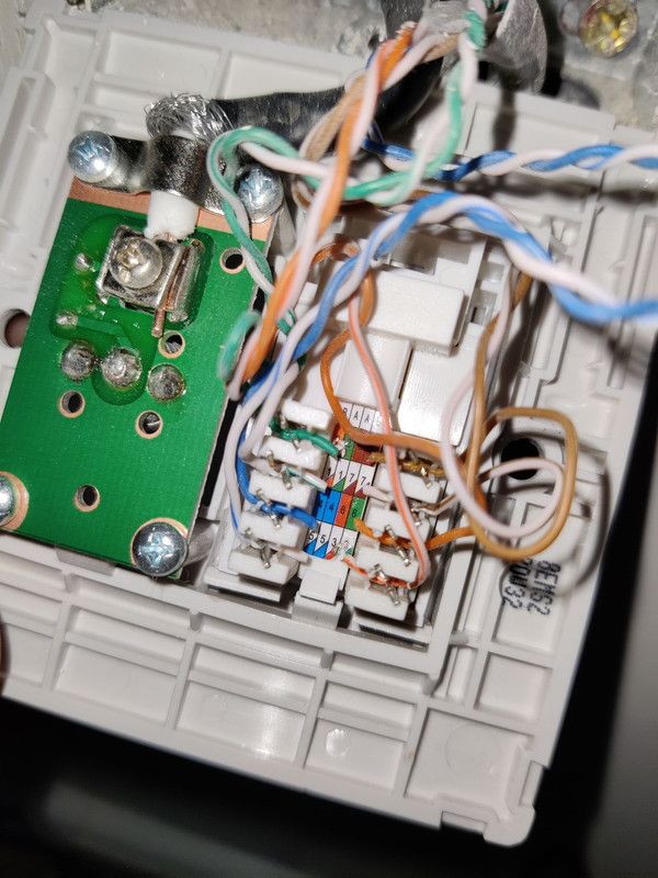

So i took the faceplate off on both sides.
Both look like they are wired straight to me? I've attached the pictures below.
Downstairs wiringDownstairs wiringupstairs wiring (its a ethernet and aerial port, hence the green board and copper wire)upstairs wiring (its a ethernet and aerial port, hence the green board and copper wire)

You need to check whether the patch leads are straight or crossover as well.
