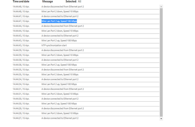

One thing I have noticed, I've gone into the system log for the hub and noticed this;
So I changed my setting on the ethernet port from auto negotiated to 100 MP full duplex. Now its not connecting at all. With auto its supposedly a 10mbps connection? Is this some kind of duplex mis-match issue?

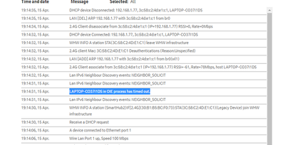

Here's a screenshot of the technical log;
LAPTOP-CO37I1DS in OIE process has timed out. No idea what that means. But it doesn't sound correct.
Should also mention I've disconnected everything, and just have ONT -> WAN & ethernet port 1 connected to upstairs with yellow BT ethernet cable.
