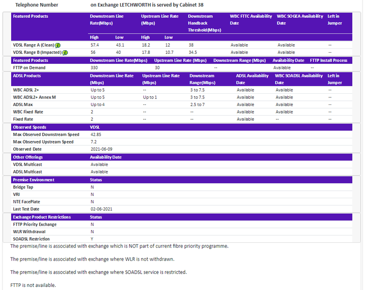

Result from the broadband check:

from dslchecker results I would expect connection speed to be better
