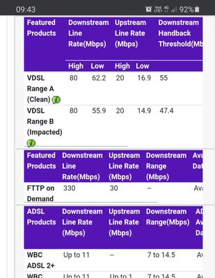

Re: Unplugged at cabinet
This is what it comes up with
You've cut off the bit we need to see to the right.
