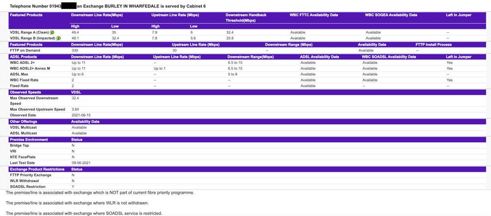

A screenshot of the availability checker is below.
