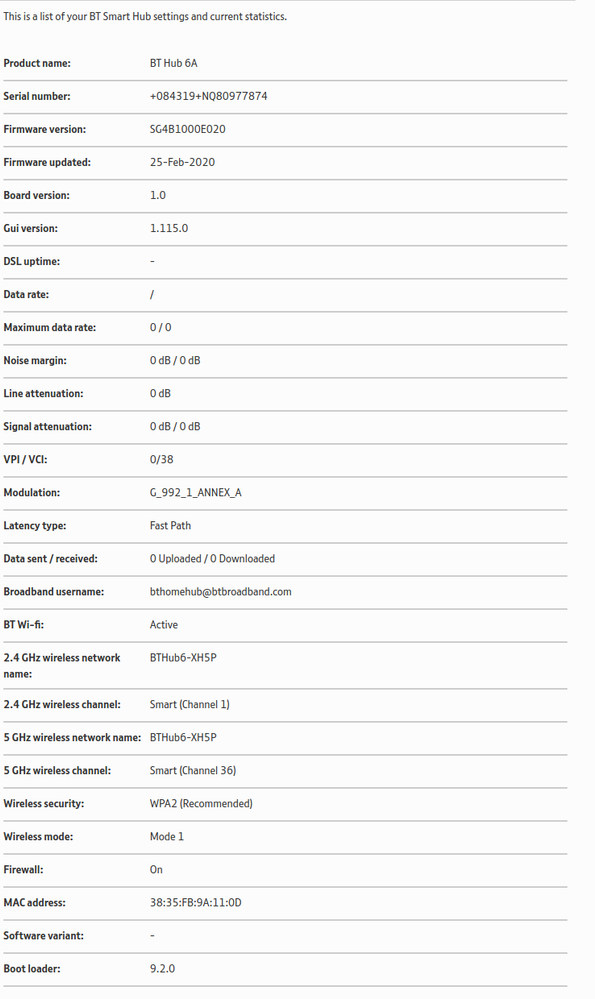

in order for the forum members to help please can you post the stats from your router (if hub enter 192.168.1.254 in your browser) and if  HH5 then go to troubleshooting then helpdesk and if HH6/SH2 then advanced settings then technical log information .

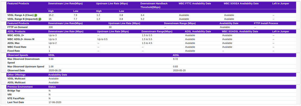

enter your phone number and post results  remember to delete number   https://www.broadbandchecker.btwholesale.com/#/ADSL

Here is the data from the HH. It was only just plugged in again about half an hour ago as I was told to try a different router on the phone by BT.

dslchecker shows you had 9.6mb connection on fibre and 9.7mb connection on your old adsl
