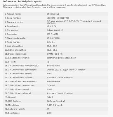

Thanks for helping, im having trouble finding the technical log, although i see " event log" under troubleshooting.
I am on the BT home hub 5 advanced settings window.

Ahh here it is, my router has been a little unstable so that's why uptime is so low haha

Your line does seem to be underperforming, you haven’t said if you tried a quiet line test, you need to use the master socket test port and with a (preferably corded ) phone, dial 17070 , quiet line test and listen , there should be no noise , if there is, report your line as noisy.
Have you tried your router plugged into the master socket test port ?, try connecting the router in the test port , and check the router stats again ( maybe post them here as well) , to see if there is an improvement.
Where do you normally plug in your router ? , the master socket or an extension socket, if the master socket do you have any extension sockets ( even if they don’t have anything plugged into them )
Your max attainable is around 21Mb with a sync rate of around 18Mb, this is below the impacted speed estimate , so chances are you have a line problem ( Openreach problem ) or your internal setup is poor ( your problem )
