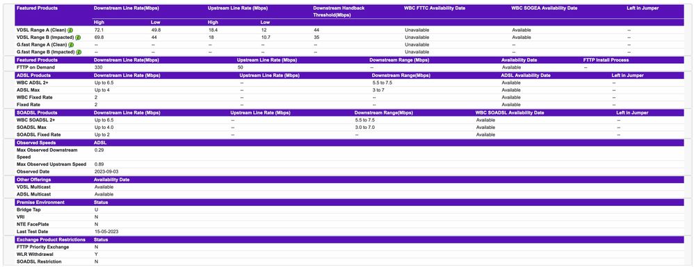

Have run the BT Broadband Availability checker which shows 0.29 Mbps down ad 0.89 Mbps up which is terrible. Even if the customer is on a slow ADSL service, they should be getting better than that.

There is obviously something wrong , although your estimate of 11Mb is way off for exchange based ADSL , something like  4-6.5Mb may be possible but TBH , VDSL / FTTC is available with much better speeds of 44-70 Mb , obviously connecting in the test port is preferable as that should eliminate any internal wiring issue , but if there is no extension sockets/wiring , then presumably the issue is either external to the property or possibly the router itself …. you should be reporting this , BT testing the line may detect a line problem and a report to Openreach raised to fix it , or an offer to replace the router if the line appears to be testing OK, but an upgrade to FTTC may be much more beneficial than getting this ADSL connection ‘fixed’.

does the person you are helping qualify here   https://www.bt.com/exp/broadband/home-essentials?s_cid=con_bt_dg-home_awin_aff_vidAJM_110483-Editori...
phone number shown and as @iniltous posted should upgrade to a better vdsl package and cost should be similar to existing cost
